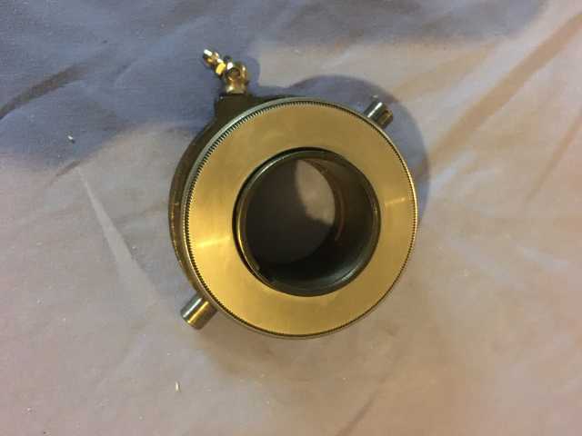

Hello Gentleman
Just for closed that subject, I've installed the clutch bearing from Automobilia Versand Company used as a closed system ( Thank's Audax!!) , but I'd stay with a lubricator in case off..
Thanks for the information's

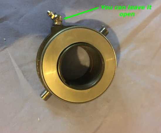

Re: Hose Clutch bearing replaced by Lubricator
Marc,
you can leave the hole open, you do not need the lubricator pin.
regards
Reinhard
regards
Reinhard
- bearing1.jpg (13.22 KiB) 35442 mal betrachtet
Ok Reinhard I,ll do that ...
