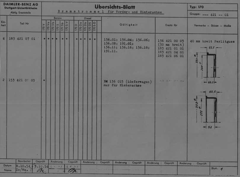

Attached: The basic drawing for the 183 421 07 01 cast iron 40 mm brake drums. As you can see, they are used on all models. And the 000 997 23 47 and other numbers for the 170V. Think of this as pre-war 170V. The brake drums are of stamped steel. As Jan and Harald clearly stated, the important facts for this part are. On Monday, I will go to my shop and take pictures of both drums side by side. You will clearly see the difference.
I was under the impression that you wanted to produce brake drums. Today, as stated, one can find good used drums in 10 years, but that will be a different story, unless drums are made. I hope this helps. Jim

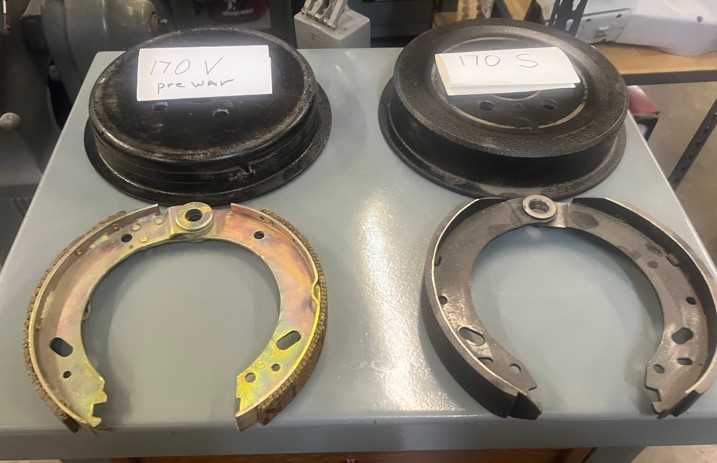

Picture of the 30 mm 170V (pre war in simple terms) and the 40 mm 170S brake drums and shoes. As stated the 30 mm brake drums are pressed steel with an external ban. The 40 mm brake drum are cast iron and used on all models including the early 220s. This includes 170V modes made after the war. Exact conversion dates can be found in the new book 170V from Hans Peter on page91. However, if you have a 170S forget about 30 mm brakes . i hope this helps. Jim
- Brake 170 S and V.jpg (27.82 KiB) 16723 mal betrachtet

Re: Fertigungszeichnung vordere Bremstrommel 170 S W 136
