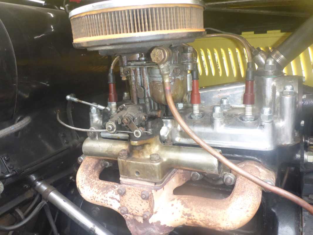

Does anyone have a Right Hand Drive 170V? The carburetor for the Right-hand drive is J F 30 downdraft thus the intake and exhaust manifold are different as well. I am interested in exactly how the manifold is shaped.

Lieber James,
in Bremen gibt es ein 170 V CA, einst nach Südafrika geliefert und später reimportiert. Vieles an dem Wagen scheint nicht mehr original zu sein. Vielleicht helfen Dir trotzdem einige Bilder davon.
Gruß Harald S.

Harald, you have solved the mystery of a spare manifold that I have in my collection of parts. I do not know how I came about this part but I have it. Yes, quite interesting the fuel pump. I suspect the RH drive had a fuel pump because the gravity feed would not work with the carburetor located above the cylinder head. Thank you for your assistance. Always much to learn about these cars. jim
