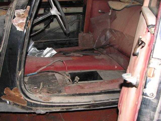

I have started restoring a pre-war 170V and have some problems

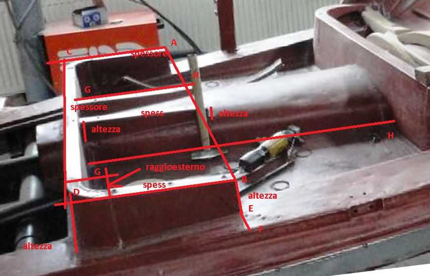

the first problem is that on my car there is no steel structure that supports the front seats.
so I will have to rebuild it but I am not in possession of the measurements of the various elements.

hier meine Vermessung der Sitzschienen Bleche
Sitzschienen vermessung.pdf
(785.83 KiB) 479-mal heruntergeladen
170 Da Bj 1950

Thanks for the info
with these data I will be able to reconstruct the structure
