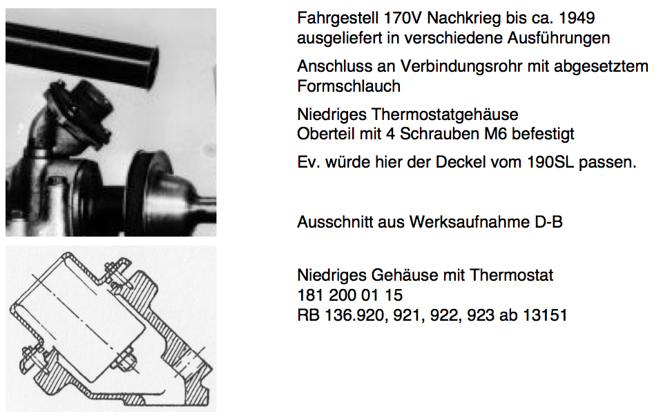

Wer besitzt ein solches Thermostatgehäuse.
Wäre Ausleihe für Ausmass und ev. Reproduktion möglich?

I have one. It would be possible to borrow. Let me know quickly as my wife goes to Nice on Tuesday and it can go into her suitcase. then she can mail it from Nice to Switzerland. She will be there for six weeks with her parents. or we can make other arrangements for a return. Also, did you see the sun visor for the 170S? jim

Habe einen gekauft von Seidel und musste den oberen Anschuss anderst Drehen

Was ich bis heute herausgefunden habe

Fantastic. Making a pattern for the aluminum housing in my view is not so difficult. Making a form die for the metal top, a bit more difficult. Certainly, a labor of love as I do not think it would pencil out in terms of cost and price. But so what. Then there is the thermostat- can a replacement part be found/ I look forward to your research. Jim
