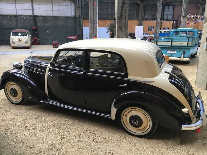

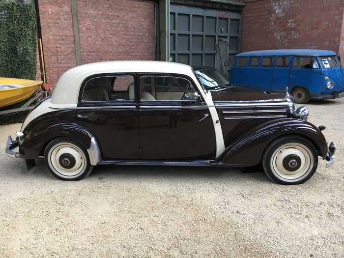

Hello MERCEDES BENZ 170 friends
Who can give me the part number for the right and left "STEINSCHLAGSCHUTZ" that can be installed on the rear wing of the 170 S "jnnenlenker"(sedan)
See added photos
Thank you

Re: "STEINSCHLAGSCHUTZ" FOR 170S SEDAN
Hi
Most of the 170S sold in Sweden are equipped with these plates.
I think that the plates are made in Sweden and has no DB-Number.
Your photo is probably showing a car with a Swedish history.
The plates are hard to find in a good shape and you must beware of that the the 170S and 170Sb has different type of rear fenders and then also different plates.

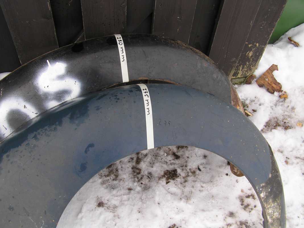

Hi Benznard
First you must check which type of fender you have.
The 170S has the black fender shown in my photo.
170Sb, 170DS, 170S-V, 170S-D, 220 (W187) all cars with Hypoid rear axle has the blue fender.
It is difficult to se the difference if you don´t have them together.
They are also different at front where to apply the plates.
I have one 170S right side plate extra and perhaps a friend of mine has both the right and the left.
He will search and reply in a short while I hope.
