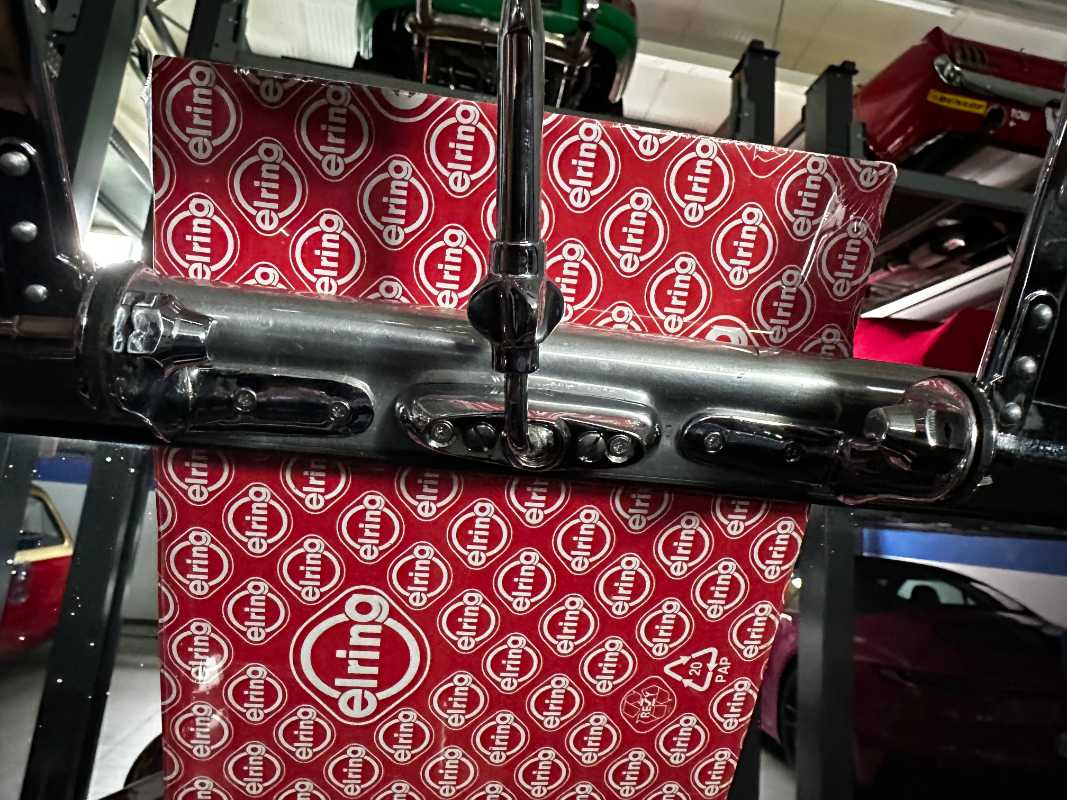

Hallo nach fast 12 Jahren bin ich fast fertig mit dem Neuaufbau.
Habe aber noch die Frage was fehlt mir noch für den Scheibenwischer und wo kommt der Motor hin?
Bildern anbei.
Dankeschön für die Antworten.
Vieleicht hat ja jemand Bilder

Bild 2

Attached are two photos of the windscreen for my 170v Cab a 1937. What is shown is the collection of parts i have for the windscreen. Of note the wiper motor is not corrct for a cabriolet, nor is the sun visor the correct length. But what is useful are the attaching hole locations. Note the mirror then the holes for the wiper motor. I believe you have installed two sun visors and eliminated the attaching point for the wiper motor. I believe with the second or right hand sun visor must be shorter to accomidate the wiper motor . Perhaps the holes were filled by mistake in the chroming process.

Thomas , I believe the 170v Cab A and cab B are the same. However there are member on the fourm that have 17O Cab b. I have these pictures as i am in the process of sortinf out my windscreen parts and getting the correct wiper motor. I had the chrome stripped and i found that my mounting holes had been filled at some point in the life of the car. The correct fastner size is 4mm. You are most welcome. if I can help further please ask. Jim
