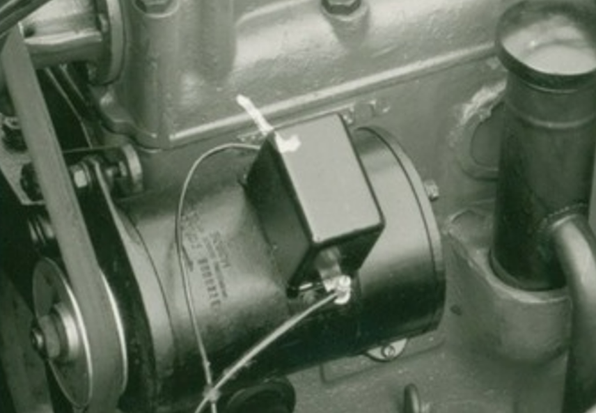

Hallo liebe Forumsmitglieder,
da meine Regelung der Ladespannung regelmäßig Probleme macht, möchte ich mir einen elektronischen Regler einbauen. Allerdings möchte ich ihn in ein Gehäuse stecken, das die Abmessungen des Vorkriegsgehäuses hat. Kann mir jemand die Abmessungen mitteilen? Ich habe zur Kärung eine Foto des gesuchten Gehäuses beigefügt. Danke für Eure Unterstützung

Jurgen, I have provided pictures of the regulator can. Perhaps a bit confusing, but they show my method of measurement. The can is 45 X 58 x69mm in simple terms on the outside. The material thickness is .5mm, so this will give you an idea of the space the original can offer- about one mm less inside than the numbers provided. The discussion on the power requirements of the voltage regulator is quite interesting. I had a solid-state regulator made in the UK, but it would not carry the generator's load when it was set up on the test machine. Then, the project fell by the wayside. I also have a 170S generator that I would like to use as an original can with a solid-state regulator. This generator is 1300 watts, so more power is required. I believe the motorcycle units lack capacity. However, with that said, I think there are solid-state units that can carry the power requirements. If necessary, slightly larger cans can be nicely fabricated to resemble the original ones. To me, that is the simple part of the job. Thank you for your sources of solid-state units. I would be most interested in your thoughts. Jim
