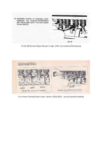

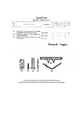

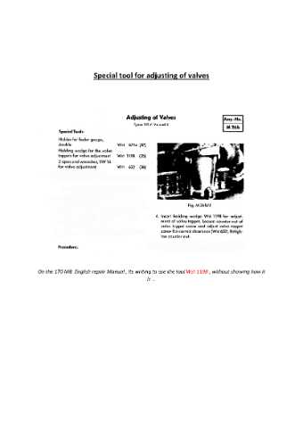

On the repair manual , they talk about one special tool nammed Wst 1198 = "Holding wedge for the valves tappet for valve adjustment"
The repair manual show it at the tool part as a very simple tool ( plate ) but I don't understand how they use it
With all the 170 owner here, I supposed that someone had that tool or use another one .
Please can someone show me with a picture or a drawing of what kind of "special tool" is ??

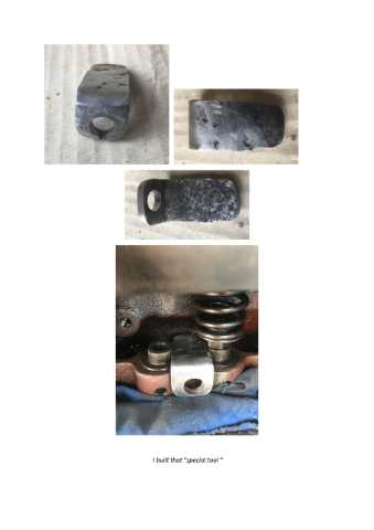

Hello Gentleman
Just for close that subject , if it can help somebody :
Outils soupapes_Page_1.jpg (10.7 KiB) 24092 mal betrachtet
Outils soupapes_Page_2.jpg (11.72 KiB) 24092 mal betrachtet
Outils soupapes_Page_3.jpg (13.4 KiB) 24092 mal betrachtet

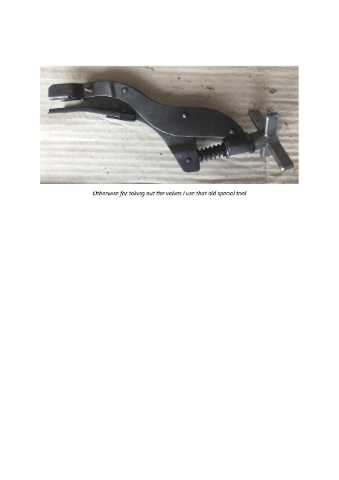

Beitrag von Marc1340 »
Outils soupapes_Page_4.jpg (11.85 KiB) 24092 mal betrachtet
Outils soupapes_Page_5.jpg (8.57 KiB) 24092 mal betrachtet

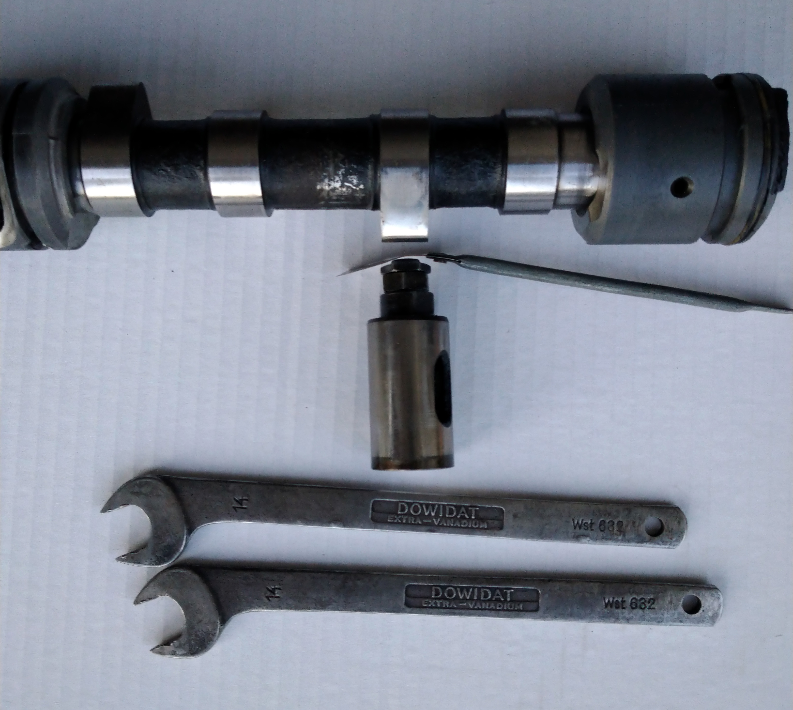

Beitrag von WilliD »
Hallo Marc- ein Bild, später kommt noch ein Bild. Gruß Willi
Ventile 1.jpg (1.28 MiB) 24037 mal betrachtet
Hallo Marc-next stepp Gruß WilliBild

Hello Willi
Many thanks for your informations and your pictures
You’ve the good tools !!
