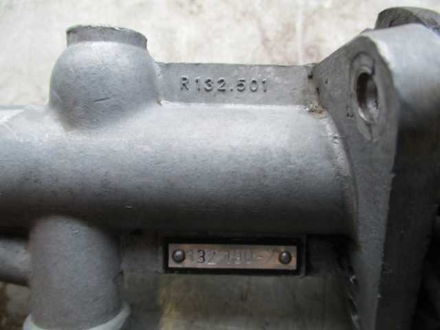

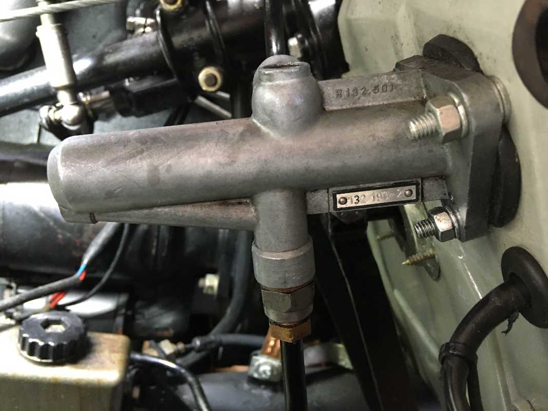

Hello,
Just to be sure before disassembling my pump and try to replace the gasket to avoid oil dripping inside the body, could you identify my pump, Vogel?
With thanks for your help,
Javier

Hi,
check page 11, the last mentioned pump is yours 132190.
The gasket is one thing but check carefully also the wear & tear of the entire plunger.
hope this helps you further.
br/b

Hi Baloke,
many thanks, now I know which pump it is will try to get the spare gaskets.
best regards,
